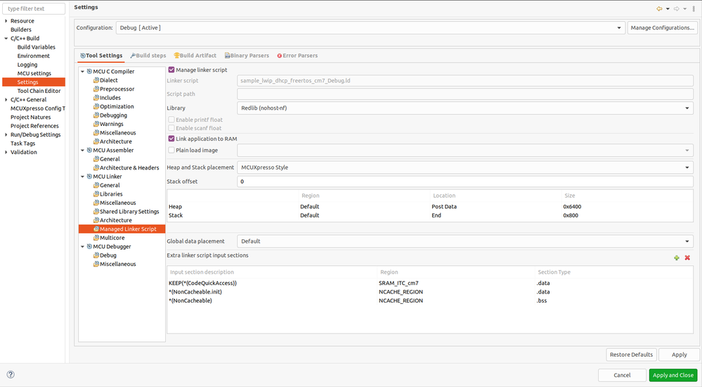

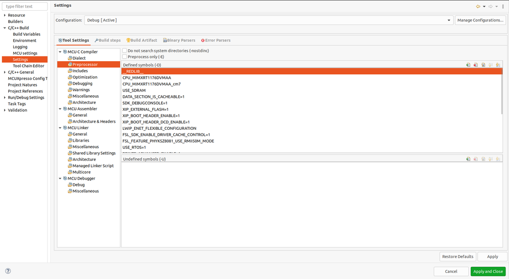

I am unable to bootup code using SDRAM. I am using lwip_dhcp_freertos_cm7 example. Following are my settings:
MCU Settings
MCU SettingsMCU Settings
Preprocessor Settings:PreProcessor SettingsPreProcessor Settings
Linker SettingsLinker SettingsLinker Settings
However, Code Boots up fine I don't link application to RAM. It also works fine when using SRAM_DTC_cm7.

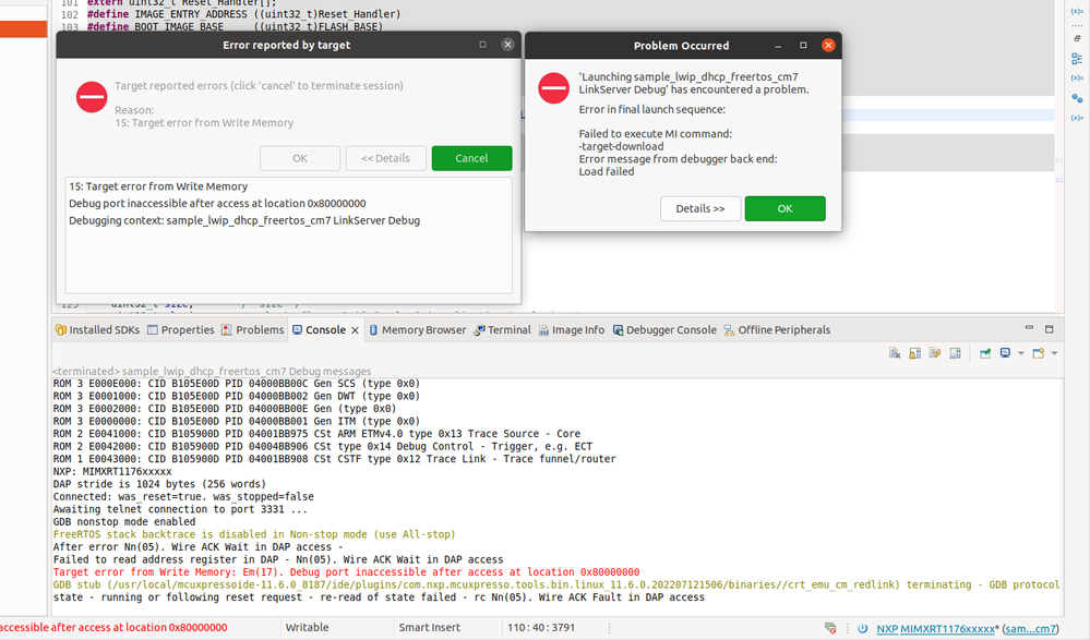

Following is the error I am getting when i hit debug buttonErrorError

2,557 Views
razools
Thanks @jeremyzhou
with the post you mentioned above
i am able to bootup my application directly on SDRAM
