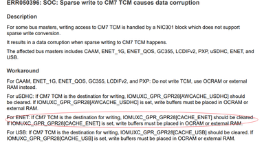

The address 0x20006780 is inside the CM7 DTCM.
According to Erratum ERR050396, ENET may have data problems when it writes to CM7 TCM.
https://www.nxp.com.cn/docs/en/errata/ES_IMXRT1170BCE.pdf
To avoid this problem,  Please clear the bit IOMUXC_GPR_GPR28[CACHE_ENET] if ENET writes to TCM.
If this bit is set, then ENET buffers must be placed in OCRAM or external RAM, not in DTCM.
Wish it helps you
Best Reagrds
MayLiu

Hi @mayliu1
Thank you for the tip - I hadn't checked potential errata.
Unfortunately it doesn't seem to be that errata though -
1. IOMUXC_GPR_GPR28 is 0x00000000 and so no write caching on ENETs
2. I tried locating the receive buffer in OCR1, OCR2 and SDRAM but in each case the behavior is exactly identical - the exact same two bytes sometimes wrong and at the same frequency.

3. The errata seems to suggest that by having MUXC_GPR_GPR28 set to 0 should be adequate to avoid the errata in TCM and these results look to confirm that it is not based on that since the same behavior is seen in the memory areas that should also not be affected by it.
Are there any further suggestions?
