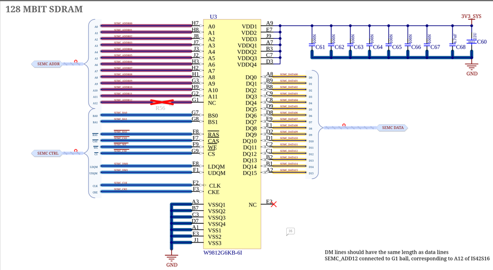

Thanks for the clarification! Is it possible to share part of your schematics for a review? especially regarding the connection between RT and SDRAM.
Kan
2,286 次查看
tbonkers
Hi @Kan_Li ,
Below is the SDRAM schematic:
2,235 次查看
Kan_Li
Hi @tbonkers ,
Thanks for the sharing !  The SDRAM schematics has been double checked by me and the expert, and we could not find any issue within it, is it possible to share your DCD file as well? and did your application code initialize the SEMC as well? Please kindly calrify.
