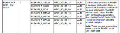

QSPI pin connection with MIMXRT1062DVJ6B mention below
So, above connections are correct or not for QSPI communication with IMXRT controller can you please verify?

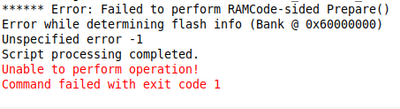

Now, When i am trying to flash code into my custom board i am facing below error in MCUXpresso IDE Console. So, How i can resolve this error?
I have also tried with JLink_Linux_V796h software using JFlashExe but have noticed same problem

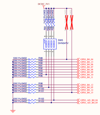

Another thing Before Programming into custom board I am using SW5 Switch as a boot configuration mode. So, any configuration required before code dump into QSPI using my custom board?.
Here, I am little bit confused how this switch works? It's work like a my IMXRT1062 processor switch between Boot mode and Application mode according to configuration. when i need to upload code that time change configuration to boot mode and after uploading code again change to configuration to run in application mode?
For that we refer switch same as SW4 which define boot mode of MIMXRT1060-EVKB.

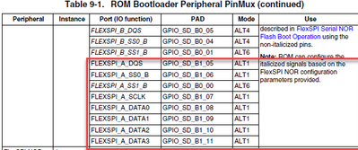

From your QSPI, they are correct to communicate with FlexSPI however you will not be able to boot from that memory as the ROM will not find the device on that configuration.
Please refer to Table 9-1 from the Reference Manual to check how to connect the booting device. This is the configuration used on the EVK:
The BT_CFG[] signals are required for proper functionality and operation and shall not be left floating during development if BT_CFG[] fuses and BT_FUSE_SEL are not configured.
You can leave Boot_Mode  pins floating if you are using boot from fuses, that means that the boot configuration is taken from the boot fuses instead of the boot_cfg pins.
Otherwise, boot_mode needs to be externally terminated so the correct boot mode is chosen correctly.

But here i am stuck because in our custom board Our Hardware person change the FlexSPI pin which i mention earlier (L13,J13,H12,H11,G12,J14). So is there any work around to change default pin to according our pins is there any modification in IDE or any configuration file which allow to do that. So Custom board able to boot from that memory and the ROM will find our custom configuration pin define and flash code into QSPI.

You will need to use the 2nd pin option, please go to the referred chapter to change this option:
You will need to change the state of the Boot_CFG pin.

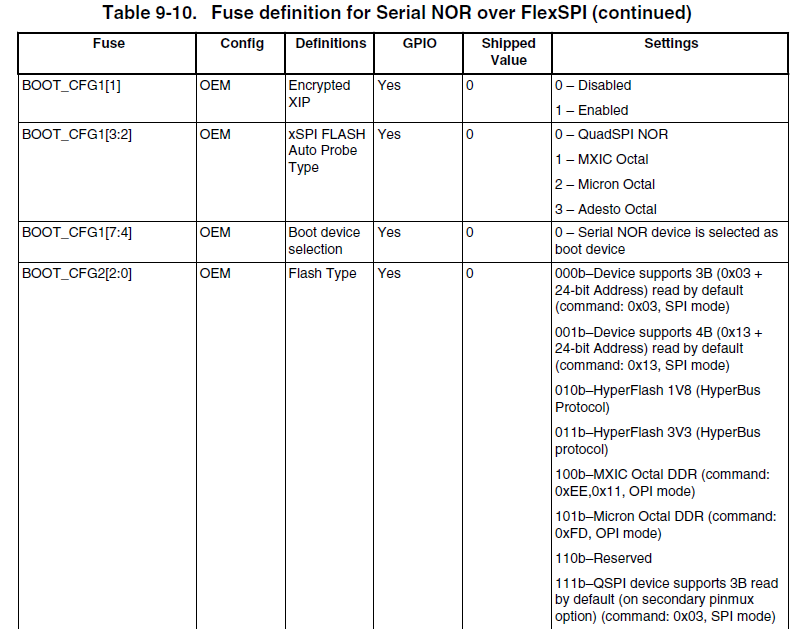

I have gone through Boot_CFG option in IMXRT1060 Processor Reference Manual.
For enabling secondary pinmux for booting, BOOT_CFG2 needs to be set to 111. So, How i can write to fusemap registers in my custom board?. I have also gone through different cases regarding for the same but i didn't get solution. I have also try with NXP MCU Boot Utility using HID for access fuse registers but i didn't connect with MCU Boot Utility.

You can burn the fuses with Secure Provisioning Tool. For this, the device needs to be on serial download mode(Boot_Mode = b01).
Before burning the fuses you need to make sure that the configuration is ideal for your booting device so first try using the boot_cfg pins on internal boot (boot_mode = b10).
Remember that fuses cannot be rewritten so we must be sure about the configuration.
