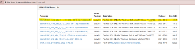

Please note I'm using the last updated version SDK available for the Embedded Artits iMX RT1062 OEM Board (see the attached image taken from the Embedded Artists website, at http://imx.embeddedartists.com/#imxrt1062).
Are there newer SDK versions from NXP for imXRT1062? If yes I'm not sure they're re fully suitable for my board using Embedded Artits iMX RT1062 OEM Board.
