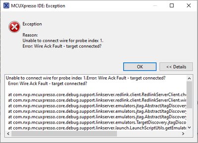

We are using imx rt1176 evk. Onboard debugger are working. But we have to use MCU-Link Debug Probe. Debugger Link
When I try to debugging with the MCU Link debug probe, I get an error like
in the pictures.
BTasdemir_0-1695134657493.pngBTasdemir_0-1695134657493.pngBTasdemir_1-1695134710740.pngBTasdemir_1-1695134710740.png
How can i solve this problem ?

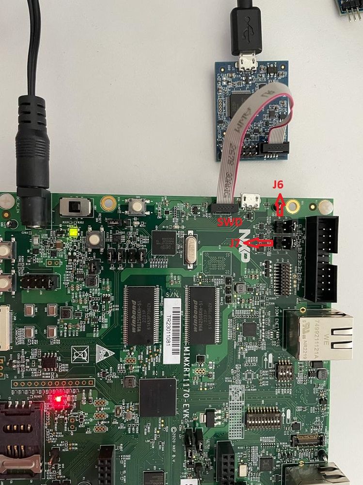

Im using RT1170 EVK and SWD interface. I removed J6 J7 but still same error.

Hello, I suggest use an adapter to use the JTAG port as a SWD flavor. I made a document related to this issue; I hope this explain more.

Hello @BTasdemir
you are using the wrong JTAG interface. This one is to debug the onboard Freelink Interface (the LPC4322 controller)
You need to use the 20-Pin JTAG interface.

lucas_cao
If you are using RT1170 EVK, please remove J6 and J7.
if you are using RT1170 EVKB, please add a jumper on JP5.
