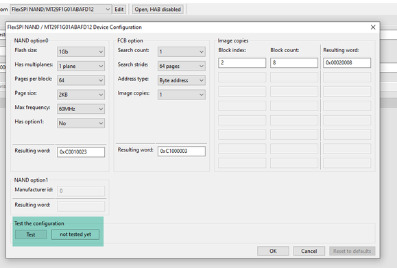

You can try to diagnose further by using our MCUXpresso Secure Provisioning tool ( version V5 added support for a NAND flash template)
I am recommending to use the tool to test your memory configuration (you can edit the  default one for MT29F1xxx ), as you can see in the above image.
If you continue to have errors could you tell me which FlexSPI port are you using?
Diego

As you suggested i have started using the Secure provisioning tool.
I am able to connect to target using via UART and made ext. flash configurations.
Tried to read the ext. memory i think it worked, showing the data as 0xff.
But when i try to erase or write its throwing error as invalid argument.
Please find the attached image FYR.
Your inputs helped and help in further debugging the issue.
Thank you so much.

We have used "MCUX Secure Provisioning Tool  v5.0" to test the flashing of external flash as you suggested.
Winbond NAND flash is not listed in the device list, so we took Flex SPI NAND /MT29F1G0xx as a boot device and applied our Winbond flash configurations and tested the simple communication.
Now we are able to build the image and write the image into external flash using the above tool, and we have verified the flashed data by reading back using flash programmer which is available in the same tool.
Out of curiosity we tried whether it boots from NAND flash or not, but booting didn't work.
 We are thinking that the image flashed by the tool is as per the NAND flash bootable image.
Please find the attached images and log FYR.
Please check them and let us know your feedback.
