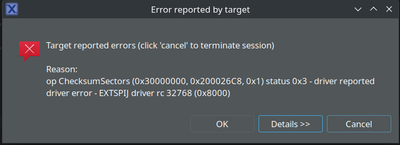

Programming a flash using LinkServer results in the following error:
When I click on OK, I can continue and flashing works, but it's annoying having to do that every time. What could be the reason for the error?

I'll be happy to just disable the warning - does anyone know how to do that?

The error seems to indicate problems at 0x3000_0000 address, but are you replicating this with our i.MX RTxxxx evks? It looks like typical RT11xx execution address for XIP images. However, I have not located the reason behind the warning, because I do not know the linkserver version, debug probe, cfx driver for your MCU and IDE version. If you are still getting this issue please provide them to me.
