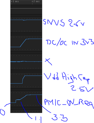

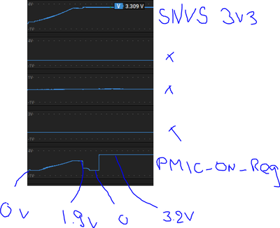

Hi All
After several days of attempting to get the boards to come up and work there has not yet been any progress and the work-arounds are temporarily being abandoned in an attempt to bring up the processor even if there is a risk of the DC/DC converter not starting or damage due to GPIO surges (although the GPIO power connection is mainly interrupted to reduce/remove this risk during most of the testing).
This allows easier direct comparisons with various reference boards with A parts that operate.
At the moment there is only one difference that is visible and that is the behavior of the PMIC_ON_REQ output.
This is how it tends to react (eg. on an 1062B part):
The 1052A board in question:
It is seen that  (other voltages not displayed since DCDC switching is delayed longr) rather than staying at 0V from SNVS IN being applied it already ramps up before then falling to 0V. After about 2ms (similar to the reference) it then rises directly to 3.2V, whereby the reference switched the output initially to 1.1V.
Does this give any clues?
Mark

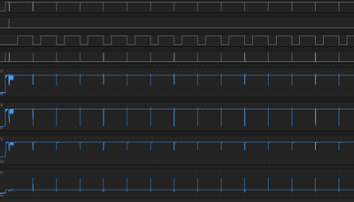

I'll show you a recording where is starts (this is the present state that I believe exactly respects the errata recommendations).
Vin is the main 3V3 input voltage that ramps from 0V to 3.3V.
The KL02 starts and waits 5ms to ensure that this is well charged before continuing since we know that it will be "challenged" later.
DCDCIN (together with VDD_HIGH_IN) is applied at the same time as DCDC_POWER is asserted (not all signals shown) and 1ms later SNVS_IN is applied. DCDC_IN is 2.95V to respect one errata point (VDD_HIGH and SNVS_IN are 3V3) and t is seen that VDD_HIGH_CAP goes to 2.5V (VDD_PLL - not shown - goes to 1.1V).
The VDD_SOC (1.1V) rail ramps up to 1.15V showing the the internal DC/DC converter starts.
VCC_GPIO is switched through 1ms later (errata requires it to be switched 2ms after DCDC_IN).
In this case it charges for about 0.5V to 3.3V, causing some visible glitches but all is OK.
I can't understand the PMIC_ON_REQ form but it is not used (just observation)
In some other instances it, however, does the following instead:
First of all the 1V1 voltage doesn't appear and then, when GPIO is applied, the input voltage fails when VDD_GPIO is switched through.
At the moment (with the more powerful supply) it tends to fail three times and is successful teh fourth time:
This may be a mixture of the DCDC converter startup errata and the GPIO inrush current errata since, when the VDD_SOC (1V1) is not successful the subsequent GPIO current is huge.
There is however a third situation which tends to take place when the processor is momentarily powered down as show here:
In this case the VDD_SOC (1V1) does come up normally but there is still a high VSDD_GPIO current when it is switched that leads to the input voltage failing. The KL02 restarts and then it is Ok again.
PMIC_ON_REQ and SNVS IN voltages are different in form (influenced presumably be internal chip state).
These also deviate somewhat to other recordings where the timing was slowed down and overall it is not obvious what is contributing to the effects but, although the boards are now starting, it looks like the workaround to ensure the internal DC/DC converter starts is not 100% reliable. When it doesn't start it presumably triggers the next errata with large in-rush current.
