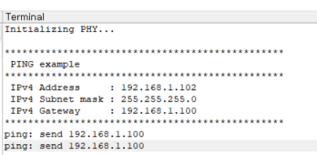

Terminal log:

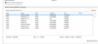

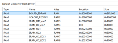

I was checked the build memory and it was shown as below:
Questions:
1. Does NCACHE_REGION belong to the SDRAM?

After checking carefully with the NXP Ping demo, I found that there was a mistake in the MCU memory region.
The lwip_ping_freertos already has the NCACHE_REGION, and I don't need to arrange another memory region.
I re-setup the system as below:

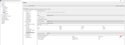

- enet_ethernetif_kinetis.c
- Enable the "Link application to RAM"
- Change symbols to "0" because we are using external emmc memory:
After changing 3 things above, the terminal log has been shown below:
There is no receiving log "ping: recv    192.168.01100   3 ms"
Please guide me on how to fix it?
