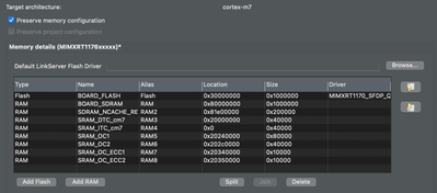

I have used the following memory configuration:

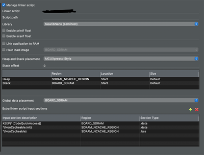

Finally, I provided the following settings for the linker:
I am not sure about the heap/stack locations (followed another thread) however even changing those back to default (post data and end respectively) the issue still occurs. Furthermore I am not sure about the Heap being allocated to SDRAM_NCACHE_REGION however another thread suggested that the heap should be allocated to an non cacheable region.

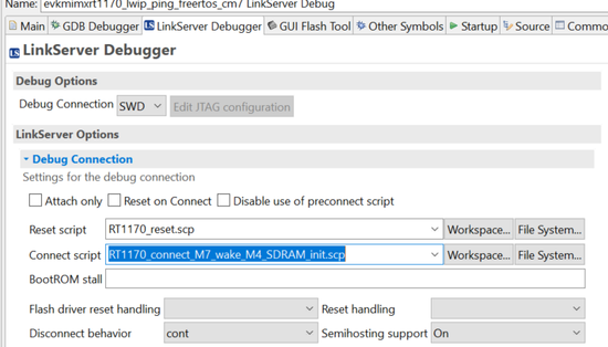

Please use this script file to initialize SDRAM before debug code.
Jing

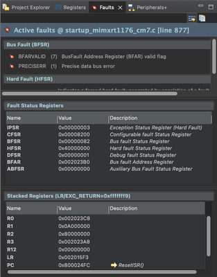

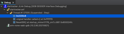

I've updated my LD script to more closely match the one you've provided in your example. This has allowed the program to get past the SystemInit function that it was previously failing on. However now it is failing while copying data sections from flash to RAM. When it fails two active faults are shown, specifically BFARVALID(7) and PRECISERR(1). Additionally a FORCED(30) fault is shown.
Here is some screenshots of the fault/registers as well as the debug thread trace:
I presume the occurence of the faults indicates an issue with the setup of the SEMC however I've gone through and can't find any issues.
Let me know if you have any suggestions.
