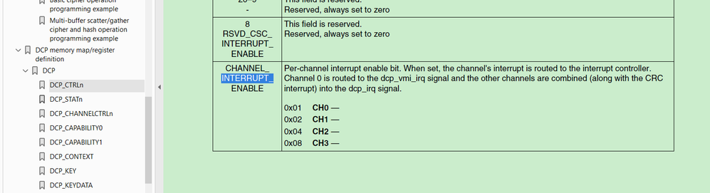

karl_fraasch
Hi Kerry,
Yes I was able to get interrupts to work for SDK's DCP DCP_AES_EncryptCbcNonBlocking function. I had to enable interrupts in control0 register.
Below is the change I had to make to "DCP_AES_EncryptCbcNonBlocking()" function inside of NXP's SDK fsl_dcp.c file.
// Added by K.F, must enable interrupts in control0 register
dcpPacket->control0 = dcpPacket->control0 | 0x0001;
FYI, I was able to get the RT1064 security reference manual. Thank you for checking.

From the secure reference manual, the channel has the interrupt bit:
You can try to enable the interrupt and add the related interrupt service code.
Until now, we still don't have the direct DCP interrupt code.
Wish it helps you!
