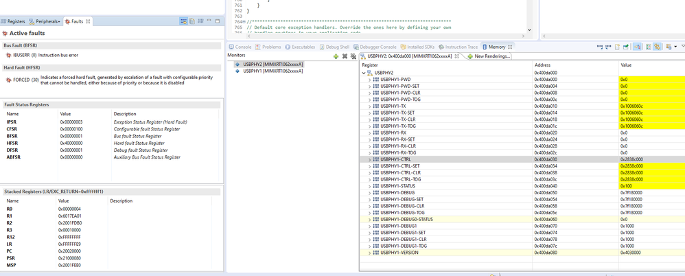

Hi Gents,
 I'm locking up when I hit the following EnableIRQ() below:

EnableIRQ((IRQn_Type)irqNumber);
The lock up only happens when I use a bootloader. Perhaps I need to clear all interrupts and set boot conditions(clear flags?)? How can I accomplish this?

Customer solution: The vector table was not moved correctly and did not have required space.
