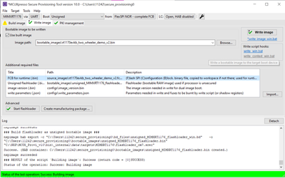

Ganesh_Pawar
Hi @Gavin_Jia
Thanks for replying regarding the firmware upgrade.
I am interested in flashing a new image through SPI/I2C .
I have flashed it using UART using secure provisioning tool by selecting the Communication interface as UART in the serial download mode. But i don't find any communication interface selection as SPI/I2C .
So can you guide me if there is any tool or am I missing any procedure here for flashing the New image using SPI/I2C
Thanks and regards
Ganesh Pawar

Ganesh_Pawar
Hi @Gavin_Jia
Thanks for the accurate Reply Much appreciated..!!!
I have finalized to flash the new image through Uart only for RT1176 MCU.
I am planning it this way:
With the help of the secure provisioning tool i am going to build the bootable image , I want to integrate the firmware update feature through android application .
Will this method of running the blhost through Uart supports through Android application and in linux systems.
If you could guide me through some supporting documents it would be of great help.
Thanks and regards
Ganesh pawar
