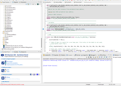

@Pavel_Hernandez, I have also one custom board with imxrt1170. The difference between my custom board with imxrt1170 and imxrt1160 eval board is that imxrt1160-EVK has no capacitors on Y5(RTC 32.768KHz crystal) capacitors on both legs. However in my imxrt1170 custom board, I have RTC 32.768KHz with both capacitors populated. When I reset the board, external RTC crytsal keeps running, but main crystal 24MHz takes reset as expected in my board.
I think the problem is that SDK example uses main external crystal 24MHz for SNVS peripheral. I quick searched but not find. How can I enable OSC32.768Khz RTC crystal and mux SNVS example in SDK to use this RTC clock instead of 24MHz one?
Actually fsl_snvs_hp.c NXP driver file does not include any definition with clock options!? See the below.Not found "SNVS_HP_Clocks" in index.
