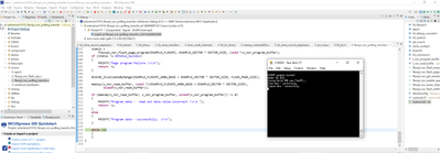

   Do you also run the :
SDK_2_15_000_EVK-MIMXRT1010\boards\evkmimxrt1010\driver_examples\flexspi\nor\polling_transfer
 in the MIMXRT1010-EVK board?
  I run it, this works OK, this is the test result:
  You mentioned, you have issues, do you use the NXP MIMXRT1010-EVK board?
Do you also work in the internal boot mode?
Please double check it again, as my side, works OK, even I downloaded to the flash, then run it directly without the debugger, also works OK
Wish it helps you!
Kerry
