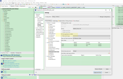

kerryzhou
Hi @tbayram ,
 Please run this flexspi_nr_polling_transfer_cm7 demo in the internal RAM at first, then share the result to me, you also need to check the LUT commander to match your used flash datasheet, thanks.
Linker to RAM is like this configuration in the MCUXpresso project:
Any updated information, please kindly let me know.

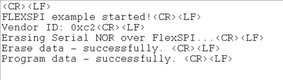

tbayram
Our result is same with yours. Is it meaning there is no problem?
5,109 Views
kerryzhou
Hi @tbayram ,
  Yes, this test result means your external flash works OK.
 Now, you can download the app image to your external flash, and boot it.
