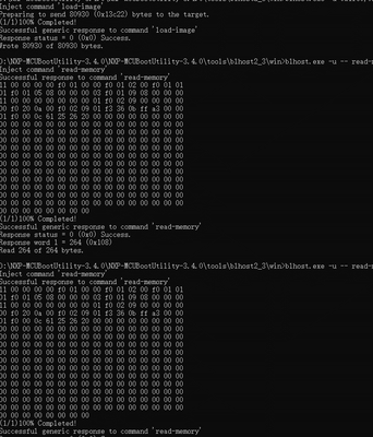

Hello nxp support ,

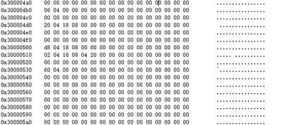

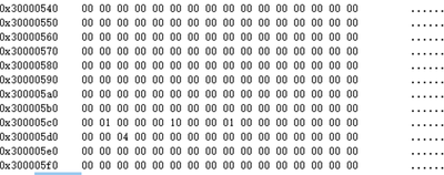

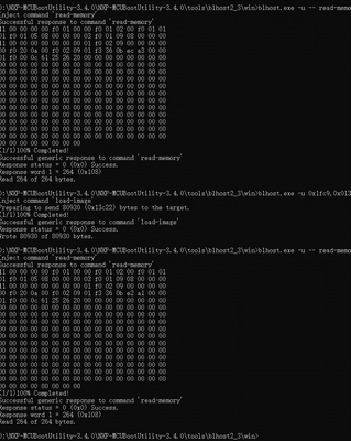

      In our project ,we  use imxrt1176 flexspi1 secondary pin group to connect a winbond  W25Q128FVSIG flash , but i can not boot ,every power on , the mcu enters serial download mode . i have burned the BT_FUSE_SEL ,SECONDARY GROUP , and i have got the rom log  by blhost  as follows,

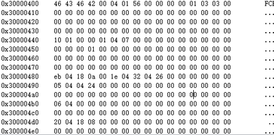

and the FDCB i used as follows:
