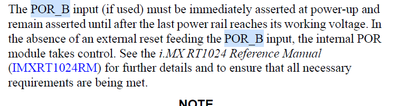

I am designing a custom board using i.mx RT1024 MCU.
In the EVK the POR_B signal is driven with a reset supervisor IC but in our schematic we would like to not use external POR as internal POR does the same function.
Are there any other issues i may face if i don't external POR? or is it normal to not use external POR?

1) Are there any other issues i may face if i don't external POR? or is it normal to not use external POR?
-- -To be prudent, I'd like to know the exact meaning of not using the external POR.

Rajender
Hi jeremy,
Thanks for your quick reply!
By mentioning external POR, i was referring to POR_B pin of the MCU which is AND'ed with internal POR of MCU. It is mentioned that if POR_B is not used then it can be unconnected or pull high but i want to know will there by any other issues during bootup/power up if POR_B left unconnected.

jeremyzhou
Thanks for your reply.
There are some issues that may arise, such as boot-up instability, can't use boot_mode pins to configure the boot mode, etc.

Rajender
Hi Jeremy,
I didn't get it! Can you please elaborate more on it? or can you please share any documentation related to it?

jeremyzhou
1) Can you please elaborate more on it? or can you please share any documentation related to it?
-- As the Hardware Development Guide for the
MIMXRT1050/MIMXRT1060 Processor, the i.MX RT needs to follow the sequence of the below power-up, further, the BOOT_MODE register is initialized by sampling the BOOT_MODE0 and
BOOT_MODE 1 inputs on the rising edge of the POR_B, to make sure the system boot with stability, it's usually recommended to use an external reset IC to connect the POR_B in the design actually.
