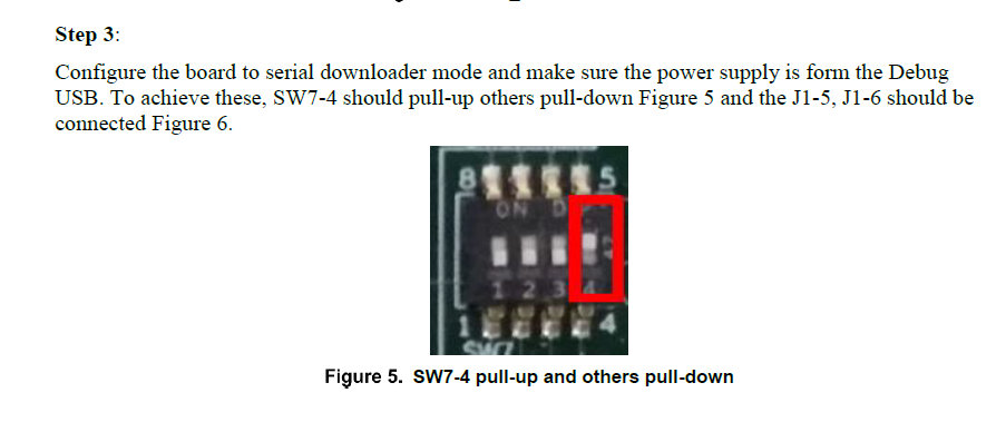

I also try to reconfigure SW7 to serial downloader and then do Mass erase procedure:

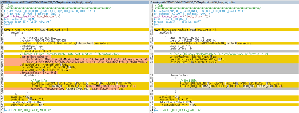

       Your configuration is not enough, you need to modify the evkbimixrt1060_flexspi_nor_config.c ,
       Comment these code:
const flexspi_nor_config_t qspiflash_config = {
    .memConfig =
            .tag = FLEXSPI_CFG_BLK_TAG,
            .version = FLEXSPI_CFG_BLK_VERSION,
            .readSampleClkSrc = kFlexSPIReadSampleClk_LoopbackFromDqsPad,
            .csHoldTime = 3u,
            .csSetupTime = 3u,
            // Enable DDR mode, Wordaddassable, Safe configuration, Differential clock
            .sflashPadType = kSerialFlash_4Pads,
            .serialClkFreq = kFlexSpiSerialClk_100MHz,
            .sflashA1Size = 8u * 1024u * 1024u,
            .lookupTable =
                    // Read LUTs
                    FLEXSPI_LUT_SEQ(CMD_SDR, FLEXSPI_1PAD, 0xEB, RADDR_SDR, FLEXSPI_4PAD, 0x18),
                    FLEXSPI_LUT_SEQ(DUMMY_SDR, FLEXSPI_4PAD, 0x06, READ_SDR, FLEXSPI_4PAD, 0x04),
    .pageSize = 256u,
    .sectorSize = 4u * 1024u,
    .blockSize = 256u * 1024u,
    .isUniformBlockSize = false,
Add these code:
const flexspi_nor_config_t hyperflash_config = {
    .memConfig =
            .readSampleClkSrc = kFlexSPIReadSampleClk_ExternalInputFromDqsPad,
            .csHoldTime = 3u,
            .csSetupTime = 3u,
            .columnAddressWidth = 3u,
            .controllerMiscOption =
                (1u << kFlexSpiMiscOffset_DdrModeEnable) | (1u << kFlexSpiMiscOffset_WordAddressableEnable) |
                (1u << kFlexSpiMiscOffset_SafeConfigFreqEnable) | (1u << kFlexSpiMiscOffset_DiffClkEnable),
            .sflashPadType = kSerialFlash_8Pads,
            .serialClkFreq = kFlexSpiSerialClk_133MHz,
            .sflashA1Size = 64u * 1024u * 1024u,
            .dataValidTime = {16u, 16u},
            .lookupTable =
                    // Read LUTs
                    FLEXSPI_LUT_SEQ(CMD_DDR, FLEXSPI_8PAD, 0xA0, RADDR_DDR, FLEXSPI_8PAD, 0x18),
                    FLEXSPI_LUT_SEQ(CADDR_DDR, FLEXSPI_8PAD, 0x10, DUMMY_DDR, FLEXSPI_8PAD, 0x06),
                    FLEXSPI_LUT_SEQ(READ_DDR, FLEXSPI_8PAD, 0x04, STOP, FLEXSPI_1PAD, 0x0),
    .pageSize = 512u,
    .sectorSize = 256u * 1024u,
    .isUniformBlockSize = true,
3. Before you download the code
   Please note this point:
Then try to download the code to your chip, after you download it, you modify SW7_2 ON, SW7_3 ON, SW7_1 OFF, SW7_4 OFF, just run the code from the external hyper flash.
Please try it, actually this is the same as the RT1050-EVKB board.

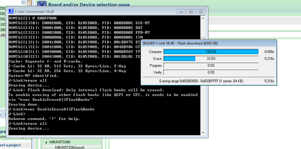

If I try to erase flash on "MIMXRT1062XXX6A" device using Jlink commander, it give me this error:
J-Link>exec EnableEraseAllFlashBanks
J-Link>erase
Erasing device...
J-Link: Flash download: Total time needed: 0.203s (Prepare: 0.154s, Compare: 0.000s, Erase: 0.048s, Program: 0.000s, Verify: 0.000s, Restore: 0.000s)
****** Error: Failed to erase sectors 0 @ address 0x60000000 (erase error)
ERROR: Erase returned with error code -5.‍‍‍‍‍‍‍‍‍‍‍‍‍‍
I tried to manually set device "MIMXRT1052XXX6A", even If  I use "MIMXRT1062XXX6A". With this settings the "erase" procedure is working.
By the way, how can I add "exec EnableEraseAllFlashBanks" while using "jlink/erase" button in MCUExpresso?

Did you modified XXXX_flexspi_nor_config.c in xip? There are some diffrerent code between QSPI Flash and HyperFlash.
Please Chechk xip foleder in your project (1050-EVKB and 1060-EVK).
