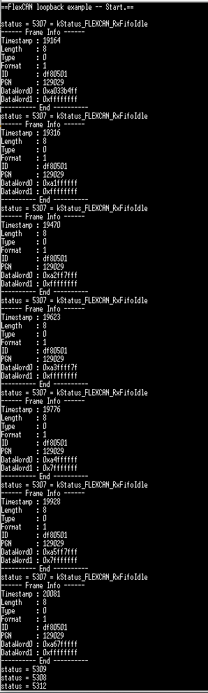

As title,
when I transmit data to my device, it only can receive 7 frames,
and then it will show RxFifoOverflow information.
like below picture
How to clear the RxFifo data to avoid RxFifoOverflow?
Or is there any suggestions to solve this problem ?
thanks!

Before answering your question, I'd like to know what board and demo code you use, otherwise I've no idea what to do next.
TIC
8,057件の閲覧回数
andydong1
Hi, jeremyzhou‌
I used imxrt1050 and SDK is 2.7.0
Example is evkbimxrt1050_flexcan_loopback_transfer.
I had modified the code to use RxFifo to receive data.

Hi. jeremyzhou‌
I think I didn't describe my procedure in detail.
In your picture, it happened because you didn't connect another device through canbus.
so it will become status=5310(kStatus_FLEXCAN_ErrorStatus),
when you use function FLEXCAN_TransferSendNonBlocking(EXAMPLE_CAN, &flexcanHandle, &txXfer);
In real conditions, our device will connect to other devices through canbus.
In my test, when I use another device to send data(more than 7 frames) to my device,
it can only receive 7 frames and then become status 5309->5308->5312.
To simplify for you to test, I have modified the code.
evkbimxrt1050_flexcan_loopback_transfer_upload.7z - Google Drive
It runs in LoopBack mode and I use for loop to send data(more than 7 frames)
It can only receive 6 frames and then become status 5309->5308->5312.
It's the same error as I met in real conditions.
Is there any solution to solve this problem?

jeremyzhou
Hi Andy Dong,
Sorry for your reply late.
Firstly, I've already replicated your issue. Then, after investigating further, I find the FIFO would overflow after receiving exceeds six frames, and the code will stop at the breakpoint as below figure shows.
It definitely is the cause of the issue, however, I'm still working on the reason of FIFO overflow event.
According to the code,  the received frame will be read after storing in the FIFO, so it's a bit weird.
