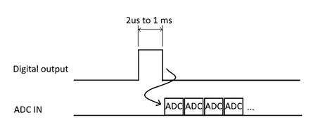

I have been working on a project that requires generation of an accurately timed pulse (2 us to 1 ms) followed by capture of a burst of sequential ADC readings (see below). I am coding in C in MCUXpresso with the EVKMIMXRT1010 evaluation board.
I have code that uses GPIO to drive the pin high, waits in a tight loop, then drives the pin low and triggers the ADC chain, but this puts an unnecessary load on the processor and can be affected by other interrupts. Ideally I would like to initiate the pulse and let the processor handle the data capture using DMA, notifying by interrupt when the array of captured analogue data is complete.
Unfortunately I am falling at the first hurdle. I have looked at both the eFlexPWM and FLEXIO peripherals but I can't get either to generate a timed single pulse (I have generated a sequence of PWM pulses using the example projects, but I can't see how to stop after just one).
Could somebody please advise whether this is possible and if so, the specific peripheral register settings required to set it up?

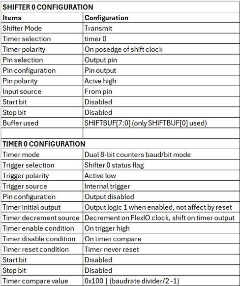

Hi @Gavin_Jia ,
Thanks for your reply. I was thinking some more about this and I wondered if I could use the FLEXIO peripheral. Using one timer, one shifter and one output pin, is it possible to set up a one-bit transfer?
Using AN12174 as an example, set the shifter and timer as below:
Do you think this would work?

Hi @RickyCoder ,
Thanks for your interest in NXP MIMXRT series!
As far as I know, the FlexPWM module is not suitable for such operation, if your goal is to trigger the ADC with PWM, you can refer to the implementation in this document, which guarantees a reliable conversion by configuring Val4/5 to trigger the ADC.
Gavin
