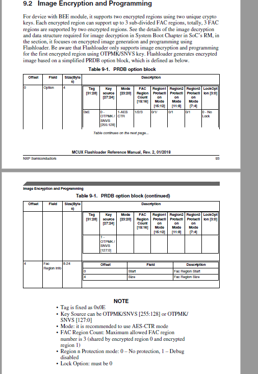

Q1) This is the extract of the program_flexspinor_image_hyperflash_encrypt.bd which in the AN12079, Session 3.3.2.
#3 Prepare PRDB options
# 0xe0120000 is an option for PRDB contruction and image encryption
# bit[31:28] tag, fixed to 0x0E
# bit[27:24] Key source, fixed to 0 for A0 silicon
# bit[23:20] AES mode: 1 - CTR mode
# bit[19:16] Encrypted region count
# bit[15:00] reserved in A0
load 0xe0120000 > 0x4000;
# Region 0 start
load 0x60001000 > 0x4004;
# Region 0 length
load 0x00001000 > 0x4008;
# Region 1 start
load 0x60002000 > 0x400c;
# Region 1 length
load 0x0000e000 > 0x4010;
# Program PRDB0 based on option
enable flexspinor 0x4000;
From all the documents available, Im unable to find any information regarding above session. I hope your side able to provides me more information on this.

srinivas_chilaka
Hi EK Hor,
Please refer the MCUX Flashloader ref manual. Its available in flashloader/doc folder.
10,456 Views
hydron
Thanks. Found it. But it seem PRDB block option cant select SW-GP2 as keys.
10,456 Views
srinivas_chilaka
There is space in effuses to store secret keys. Look at RF for 1050 Chapter 5: Fusemap.
Look for GP1, GP2, GP3, SW_GP1 fuses. They are 32bit wide.
Look for SW_GP2 fuses. It is 128bit wide.
Fuses GP1_LOCK, GP2_LOCK, SW_GP1_LOCK, SW_GP2_LOCK, SW_GP2_RLOCK, GP3_LOCK can lock these fuses.
They all are OTP.
10,456 Views
hydron
Thanks for replying. I knew SW_GP2 fuses is OTP.
Maybe my question is not clear enough. My main objective is to generate encrypted image using SW_GP2 as keys.
From example given, the elfosb capable to do it using OTPMK as keys. But out there do not have reference for generating encrypted image using SW_GP2 as keys.
