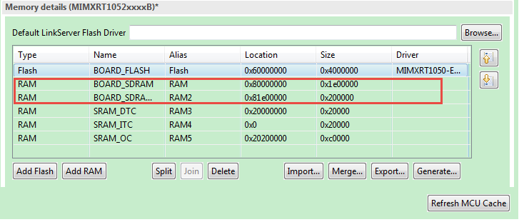

My program has outgrown the internal RT1050 RAM and I need to use the external SDRAM on the EVK. I tried using the example FreeRTOS Hello World project as a known good. I am having issues with my project and the Hello World project. I either get hard faults or the program crashes at the clock configuration.
I followed the "Using the MIMXRT1050-EVK(B) with MCUXpresso IDE v10.2.1" to try and configure my project to use the SDRAM. I noticed that the SDRAM example that is used in the document is for linking only to the SDRAM. I need to store the project and flash and use the SDRAM as my main memory. I tried the stock linker script and also tried changing the addresses to 0x8xxxxxx instead of 0x4xxxxxx, since that is the location of the RAM in the MCU Settings menu.

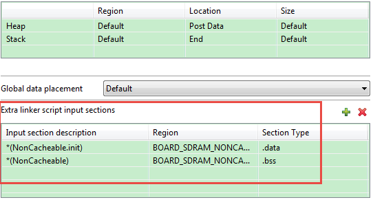

The evkbimxrt1050_sdram_init file is used to initialize the SDRAM when debugging the demo project in the Keil, I find the evkbimxrt1050_freertos_hello is based on MCUXpresso, definitely, the evkbimxrt1050_sdram_init file is not fit it, so please follow the below steps to use the SDRAM as major RAM.
1. Add the XIP_BOOT_HEADER_DCD_ENABLE=1
2. Modify the memory assignment
2. Modify the extra linker script input sections

After digging deeper, I find that evkbimxrt1050_lwip_ping_freertos_SDRAM can work property after disabling the Cache feature via the comment out the below code in the BOARD_ConfigMPU(void);, please give a try.
    MPU->RBAR = ARM_MPU_RBAR(8, 0x81E00000U);
    MPU->RASR = ARM_MPU_RASR(0, ARM_MPU_AP_FULL, 1, 0, 0, 0, 0, ARM_MPU_REGION_SIZE_2MB);
    /* Enable MPU */
    ARM_MPU_Enable(MPU_CTRL_PRIVDEFENA_Msk);
    /* Enable I cache and D cache */
    //SCB_EnableDCache();
    //SCB_EnableICache();
