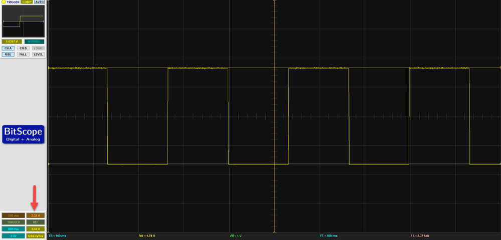

Hi ı am using MIMXRT1052 on custom board. I am  using  MCUXpresso as an ide with  SDK_2.7.0_MIMXRT1052xxxxB. I tried to use GPIO2  pin 22 for interrupt. But ı cant get any interrupt. I examin examples of GPIO input and GPIO output.
When I modified the output sample for GPIO2 22nd pin, I measured the output with an oscilloscope. No matter how I make changes using the pin config tool, I get a maximum output of 1.16v. In the Input example, I can see the interrupt signal with the help of an oscilloscope (3V), but if I complete the connection between the signal and the processor, I see a signal at the mV level. Am ı skipping an adjustment ? Is that normal?

Hi Victor,
-Just to be sure that I understood the behavior you are facing correctly. You configured pins GPIO_B1_06 and GPIO_B1_14 as output and when you send these pins to a high level you get only 1.6 volts, am I correct?
Yes ı configured  GPIO_B1_06 and GPIO_B1_14 pins as output when we tried to toggle or send high level, measured  1.1V - 1.4V.
-Do you see this behavior in our EVK or on a custom board?
Pin configurations not suitable  for output on evk (ethernet pins) but we get 3V from TP 26.

Hi Omer,
Based on your response I understood that you are seeing this behavior on a custom board, is this correct? If so, what is the value of the power-rail that supplies power to these two pins?

Hi Victor,
NVCC_GPIO(3V) supplies these two pins and other GPIO2 pins. Only GPIO_B1_06 and GPIO_B1_14  not give 3V output.

Hi Omer,
I made a couple of tests on my side with the RT1050-EVKB and I wasn't able to reproduce the behavior that you mentioned. I configure pin GPIO_B1_14 as GPIO2_IO30 and I toggle the pin in a while loop, I was able to see that level of the pin goes up to 3.3 volts.
With the help of the MCUXpresso Config Tools, I added the following code inside the function BOARD_InitPins.
IOMUXC_SetPinMux( IOMUXC_GPIO_B1_14_GPIO2_IO30,  0U);
After that, in the main, I initialize the GPIO pin.
GPIO_PinInit(GPIO2, 30, &led_config);
Where led_config has the following parameters.
gpio_pin_config_t led_config = {kGPIO_DigitalOutput, 0, kGPIO_NoIntmode};

omerkaanbasakin
Hi Victor,
Thanks for your reply. We can get 3V any pins from processor except GPIO_B1_06 and GPIO_B1_14. We didnt know that pins can deform seperately. Thanks for your time.
