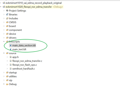

You can find this folder in the project file of the SDK example:
It controls the linkfile generated by the IDE, resulting in the following final generated image:
That is, even though the project is XIP, the FlexSPI related code is still executed in RAM.
Gavin

Hi @Gavin_Jia ,
I am using the armgcc SDK on Linux, so I modified my linker script as per "MIMXRT1042xxxxx_flexspi_nor.ld". Now if I step debug through the application it works fine. I am able to initialize, then read, program and erase. But if I run the program crashes, i.e. HardFault_Handler gets called at "FLEXSPI_SoftwareReset()" inside the init function.
Any idea what could cause the program to crash?
