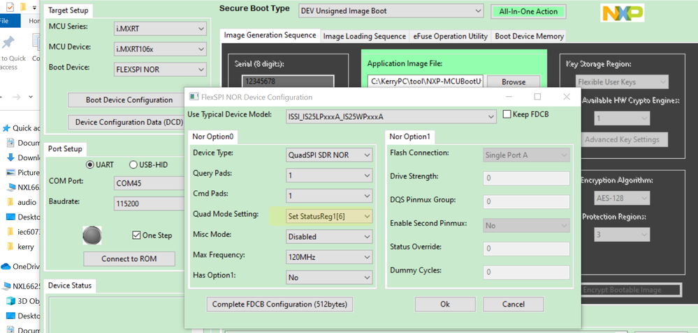

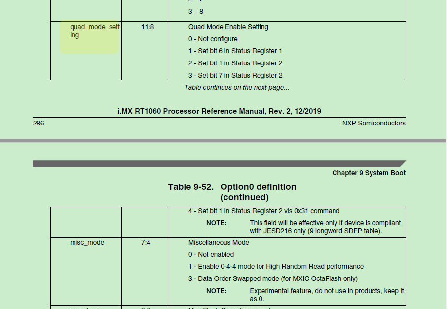

   Do you mean, after the recommended  polling_transfer application, now all works OK?
   If yes, it should related to the QE bit, as you know this bit is the Non-Volatile bit, to the new chip, it should be enabled at first.
   Please do more testing, any updated information, just kindly let me know.
  BTW, you also can use the  MCUBootUtility tool to download the code to the new chip:
https://github.com/JayHeng/NXP-MCUBootUtility/archive/v2.4.0.zip
the related user manual is:
Wish it helps you!
Kerry

  Enable the QE bit is not set up with .sflashPadType = kSerialFlash_4Pads,
  It normally in the project related program flashloader files. The option defines it:
  Or the polling code like this to enable it:

BTW, do you use the MCUBootUtility to download the code? That tool will help you to generate the qspiflash_config directly.
