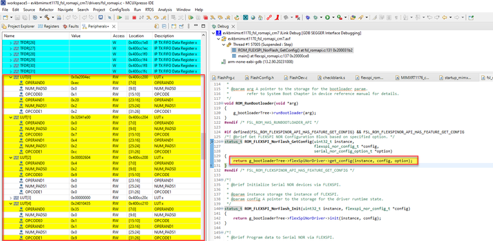

I've got a question regarding using the get_config function in the FlexSPI ROM API:
On the RT1060 I have a flash configuration block in the first 4KiB of my image (starting from 0x60000000). However, when calling
g_bootloaderTree->flexSpiNorDriver->get_config
the configuration returned doesn't match the one in flash, which I assumed it would. So, I'm wondering what the function actually does, does it 1) return the configuration that's in flash, or does it 2) communicate with the flash chip to determine the configuration, or does it 3) do something else?

Hi @dafela
As you saw, the bootROM does get some LUT information from the Memory, discovering its specific configuration, if it is compliant to the related JEDEC SFPD standard. See an example from the i.MX RT1170 ROMAPI demo.
You can see that after calling the get_config API of the bootROM, the FlexSPI LUT contents get updated.  Additionally the config structure that the API resides, this structure is located in RAM and used later on by the example.
The bootROM development team considered that in the market will be a very wide range of memory manufacturers, so they decided to not save the configuration of any memory, as we can use the JEDEC standard.
As a related topic to the memory parameter discovery, the MCUXPresso IDE integrates some generic or in some cases more specific flash drivers. The generic drivers use the bootROM for parameter discovery. The below chapter from the IDE user guide introduce this.
I hope this could help, let me know if you are still having any more questions or comments.
