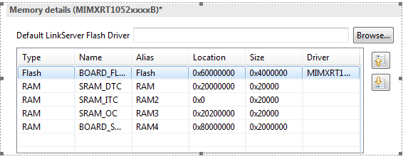

I want to run an application on a i.mx rt1052 with the following RAM config:
DTCM: 256k, ITCM: 128k, OC: 128k (default values: DTCM: 128k, ITCM: 128k, OC: 256k)
I want to reconfigure the FlexRAM at runtime, not with the fuses...
I tired the SDK example evkbimxrt1050_flexram_ram_allocate which works fine. In this example, the memory details in the Project properties (Linker settings) are configured to the default values of the FlexRAM, not the values to which the RAM is finally reconfigured in code. This way i can only use the default RAM space at compiletime, because otherwise the linker complains (not enough space in RAM).
But as soon as i reconfigure the Memory details in the Project Property window to fit my needs, the linker is happy, but I get debugger errors at startup (not all RAM accessible). Because the RAM is not jet reconfigured (no code is executed jet).
Any Idea how to get around this problem?

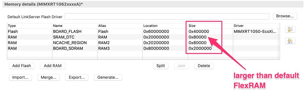

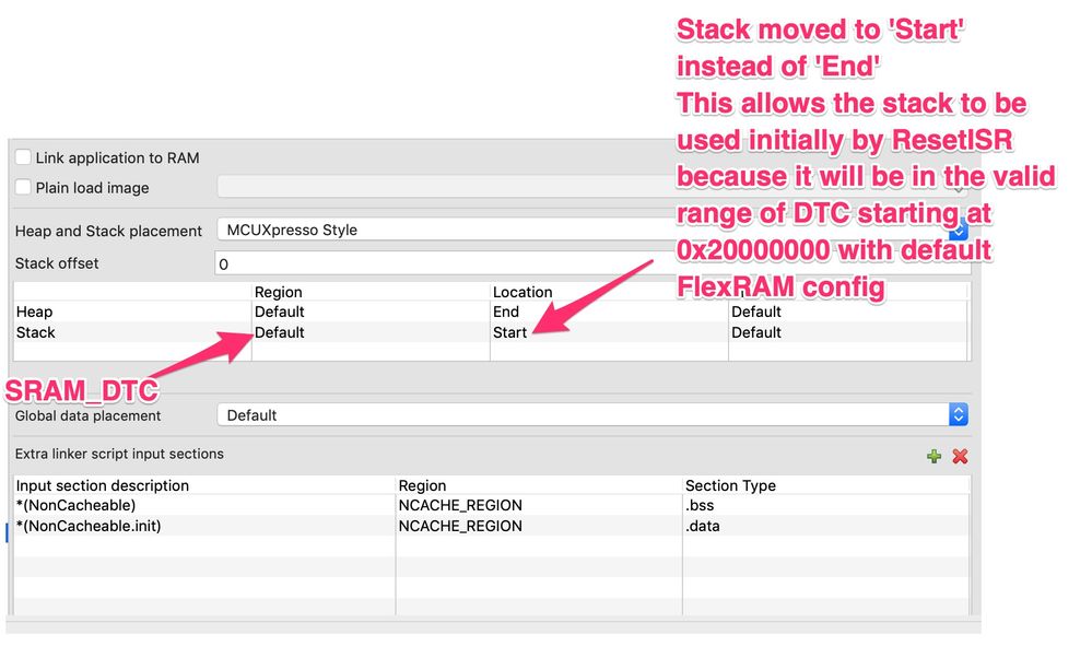

jackking
Senior Contributor I
I was able to change the project to locate stack at the beginning of the DTCM memory section instead of the default at the end.
This allows the stack to be used by ResetISR in a valid memory range before the FlexRAM is reconfigured.

jackking
Kerry,
Please see my update above...  moving the stack to the beginning of the memory range fixes my issue.
21,103件の閲覧回数
kerryzhou
Hi Jack King,
   Thanks so much for your sharing, and it's good to hear you make it work by moving the stack.
    Could you please also give a screen about your stack modification? It will be more useful to the other customer.
   Thank you!
Kerry
21,080件の閲覧回数
jackking
OK, I updated my previous post with some screenshots.
21,080件の閲覧回数
kerryzhou
Perfect, I will also find time to test it on my side. Thanks for your contribution.

jackking
Is there any update on this?
I have the exact same issue. I am trying to set DTCM to 512k, with my stack located in DTCM.
The ASM flexRAM settings work, but the program will crash on entry into ResetISR if the linker is configured with 512k DTCM in the project
My DTCM usage is greater than the default, so the linker will error if I set the project to the default memory.
21,118件の閲覧回数
