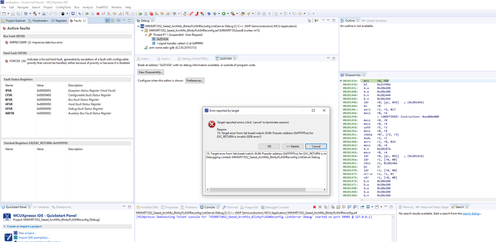

  You said:  but I get debugger errors at startup (not all RAM accessible).
Could you also give me a screenshot about it, I will find time to test your situation, and give you reply later.
Kerry
5,618 Views
david_huwyler
Sure:

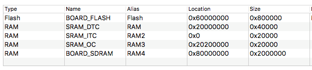

I changed the Linkerfile Memorymap to DTCM: 256k, ITCM: 128k, OC: 128k:
(I use a seeed studio arch mix board with 8M qspi flash)
Now i set a breakpoint at the 1. executed Codeline in the startup code and start the debugger. The debugging actually works until now:
If I now do a "step into (F5)" the following error occurs:

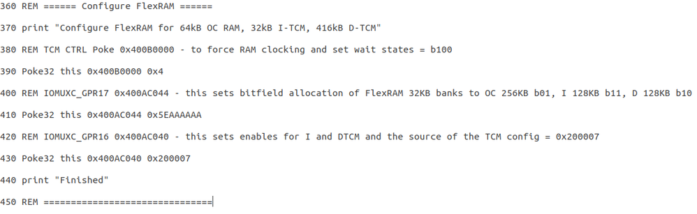

A way to work around this would be to make use of a LinkServer Connect Script to setup the FlexRAM - the example below actually restores the default values but could be changed to set the new values required.
360 REM ====== Configure FlexRAM ======
370 print "Configure FlexRAM for 256KB OC RAM, 128KB I-TCM, 128KB D-TCM"
380 REM TCM CTRL Poke 0x400B0000 - to force RAM clocking and set wait states = b100
390 Poke32 this 0x400B0000 0x4
400 REM IOMUXC_GPR17 0x400AC044 - this sets bitfield allocation of FlexRAM 32KB banks to OC 256KB b01, I 128KB b11, D 128KB b10
410 Poke32 this 0x400AC044 0x5555FFAA
420 REM IOMUXC_GPR16 0x400AC040 - this sets enables for I and DTCM and the source of the TCM config = 0x200007
430 Poke32 this 0x400AC040 0x200007
440 print "Finished"
450 REM ===============================
The connect script can then be referenced within the projects LinkServer launch configuration.

If this is done, then the project can be configured using the projects MCU memory configuration to look something like this:
The result will be that the Image and the target memory will match for debug operations.

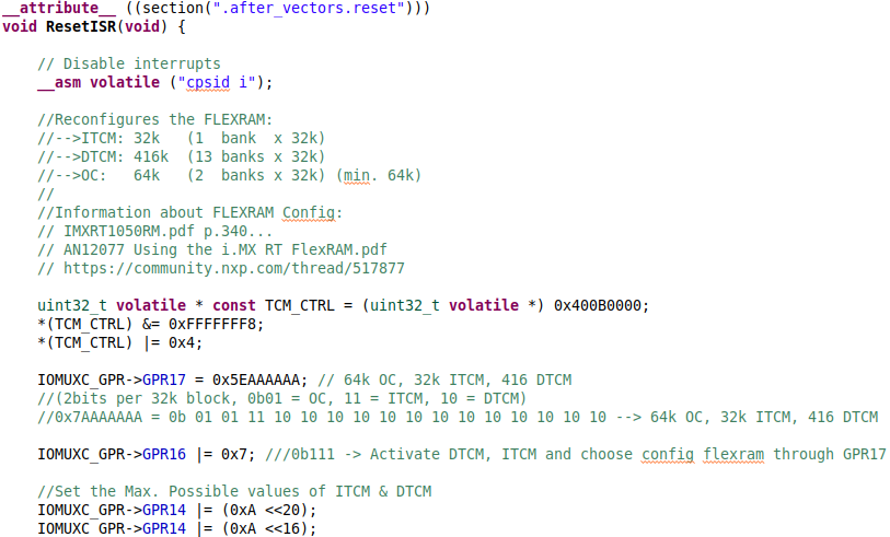

I tried the workaround you suggested.
Startup Code:
Linkserver Connect Script:
And it works as long as I start the target with the debugger attached.
If I start the target without the debugger, the application crashes.
As far as i can see, i do the same tings in the startup code, as in the Linkserver Script.
Any idea why it dosnt work without the debugger?
