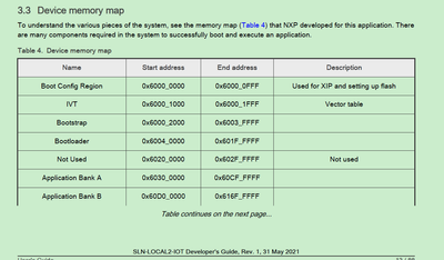

kerryzhou
Hi @jnj ,
  It's also easy to realize.
  You can generate the bootloader.bin, then use the mcubootutility tool to download directly in the serial download mode with USB or the UART.
  You can refer to my post:
https://community.nxp.com/t5/i-MX-RT-Knowledge-Base/RT106L-S-voice-control-system-based-on-the-Baidu...
chapter 2.3 playback audio data prepare and burn
The bootloader related area, you can find it in the UG pdf:
Wish it helps you!
Kerry
