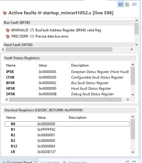

Hello ı am using Mcuxpresso and MIMXRT 1052 on custom board. I use IS25LP064A qspi flash as flash. Debug the code with PE Micro Universal Multilink. When ı debug the code, faults occurs. Also   tried to use GUI Flash Tool and errors occurs (loading abort). When ı link application to ram ( project > properties > c/c++ build > mcu setting > enable link aplication to ram) code works perfectly.
Memory Settings  :
P.S. : I tried 3 drivers as a flash driver : MIMXRT1050-EVK_IS25WP064A.cfx , MIMXRT1050_SFDP_QSPI.cfx, MIMXRT1020-EVK_IS25LP064.cfx. Result not changed.
Faults:

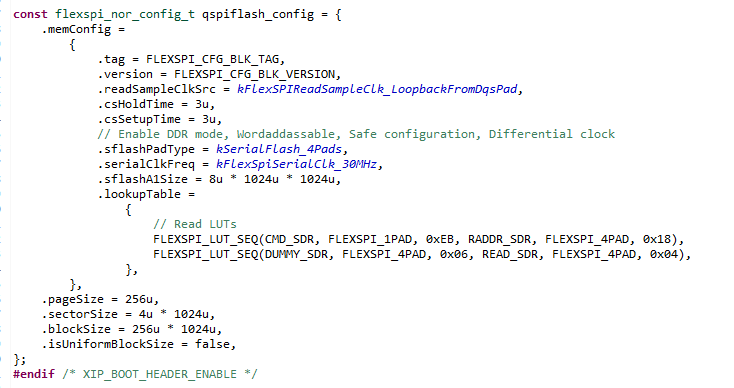

1) Would you please inform us of the related pin configurations (boot mode, etc.) and software drivers and IDE configuration that are needed?
-- Regarding the software side, you should below qspiflash_config to replace the original struct in the SDK demo.
const flexspi_nor_config_t qspiflash_config = {
.memConfig =
.tag = FLEXSPI_CFG_BLK_TAG,
.version = FLEXSPI_CFG_BLK_VERSION,
.readSampleClkSrc = kFlexSPIReadSampleClk_LoopbackFromDqsPad,
.csHoldTime = 3u,
.csSetupTime = 3u,
// Enable DDR mode, Wordaddassable, Safe configuration, Differential clock
.sflashPadType = kSerialFlash_4Pads,
.serialClkFreq = kFlexSpiSerialClk_100MHz,
.sflashA1Size = 8u * 1024u * 1024u,
.lookupTable =
// Read LUTs
FLEXSPI_LUT_SEQ(CMD_SDR, FLEXSPI_1PAD, 0xEB, RADDR_SDR, FLEXSPI_4PAD, 0x18),
FLEXSPI_LUT_SEQ(DUMMY_SDR, FLEXSPI_4PAD, 0x06, READ_SDR, FLEXSPI_4PAD, 0x04),
.pageSize = 256u,
.sectorSize = 4u * 1024u,
.blockSize = 256u * 1024u,
.isUniformBlockSize = false,
The boot mode is determined by the boot pins, please check them carefully and assure boot up from the QSPI flash.

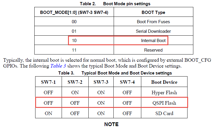

jeremyzhou
Hi Omer Kaan Basakinci ,
Thanks for your reply.
1) Is this OK, or do we have to make other changes?
-- It's not enough to set the  BOOTMODE(1:0)=10, please set the boot pins as the below figure to select to boot from the QSPI.
TIC

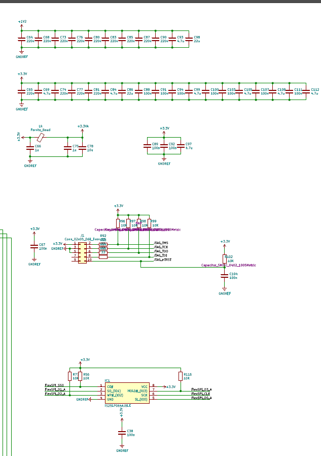

omerkaanbasakin
Hi jeremyzhou‌,
Following to your suggestion , we ran the flexspi_nor_polling_transsfer demo in the ram. We run the code stpe by step. According to the code "erase data - succesfully" and "program data- succesfully".
Some of our schematics :
Kind Regards.
7,463 Views
jeremyzhou
Hi Omer Kaan Basakinci,
Having a brief review of the schematic, I don't find something wrong, and according to your reply, the flexspi_nor_polling_transsfer demo works well, it can verify that the hardware circuit about the IS25LP064A is good too.
