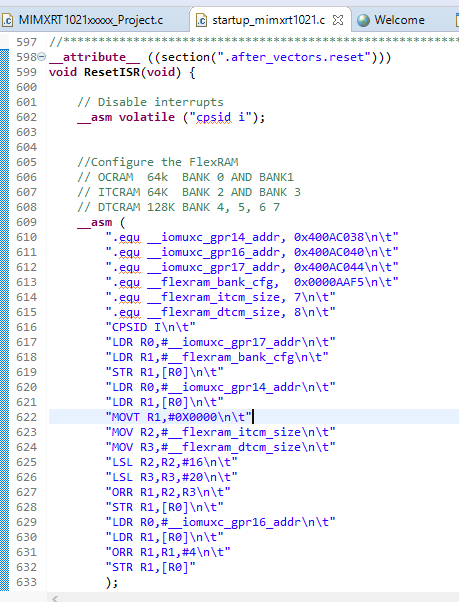

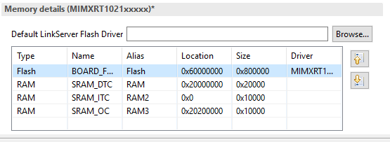

I'm having problem to configure the FlexRAM in MIMXRT1021DAF5A, based on AN12077
I want to setup the following configuration
and in the startup file I initialize the flexram controller with the following code

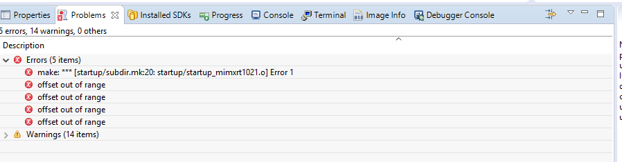

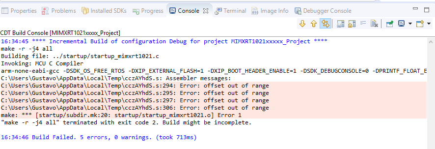

the problem that I have is I obtain compiller error that I cannot trace
I could not understand where is my error if any could help me it is appreciated
