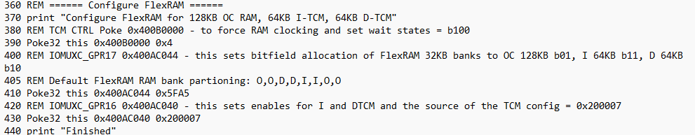

Dear all
I am recently updated to MCUXpresso v11.10.0, and use SDK 2.15 for RT1024 EVK, I am tried to reconfigure FlexRAM to be difference sizes and get rid of external RAM, however, it comes with an error like attached image. I am trying to follow the link https://community.nxp.com/t5/i-MX-RT-Crossover-MCUs-Knowledge/Reallocating-the-FlexRAM/ta-p/1117649, and it worked for me with previous version on SDK 2.12 and IDE v11.8. is anything changed that resulted it not working any more?
Regards!
Ping

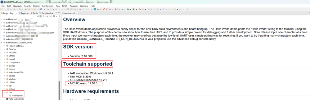

Hi @ping1 ,
I suggest you check if your MCUXpresso IDE and SDK versions are compatible.
For example:
Please import a SDK demo,  for example "evkmimxrt1024_hello_world"
Open readme.md, in this file, you can see detail information.
Wish it helps you.

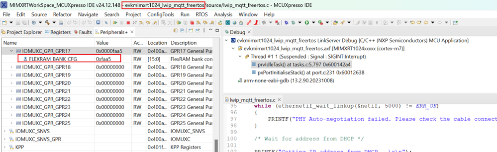

MCUXPresso IDE version is MCUXpresso IDE v24.12
SDK version : 24.12.00
I use MIMXRT1024-EVK board and SDK demo"evkmimxrt1024_freertos_hello",
I also reconfigure FlexRAM to be difference sizes.
I refer to this link https://www.nxpic.org.cn/module/forum/thread-619452-1-1.html
My demo runs Ok, no errors.

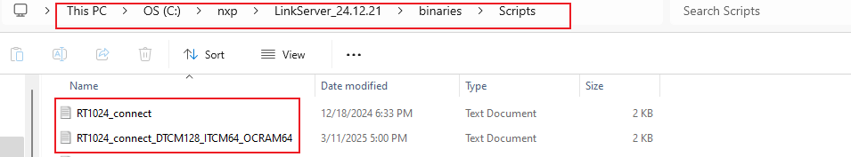

Regarding "where can I find the RT1024_connect.scp please?"
Please refer to next link.
Please check the difference, If you still have problems, Please create a new works space, and try again.
