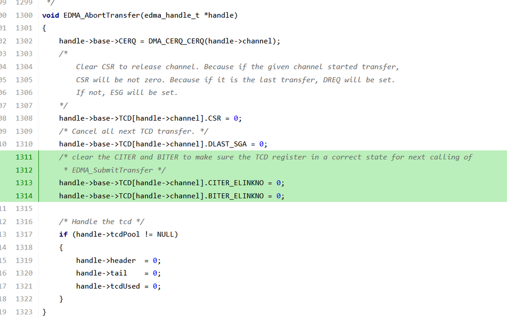

There's a new bug introduced in the 2.8.2 SDK for iMX RT1010, in EDMA_SubmitTransfer(). The function now also checks if the TCD's CITER != BITER, which actually will be the case if the EDMA_AbortTransfer() is called while the transfer is active. This will result in EDMA_SubmitTransfer() to return busy, preventing the restart of the EDMA transfer, contradicting the statement at EDMA_AbortTransfer: "Users can submit another transfer after calling this API."
The details of the new busy condition:
         *    Check if EDMA channel is busy:
         *    1. if channel active bit is set, it implies that minor loop is executing, then channel is busy
         *    2. if channel active bit is not set and BITER not equal to CITER, it implies that major loop is executing,
         * then channel is busy
         *    There is one case can not be covered in below condition:
         *    When transfer request is submitted, but no request from peripheral, that is to say channel sevice doesn't
         *    begin, if application would like to submit another transfer , then the TCD will be overwritten, since the
         *    ACTIVE is 0 and BITER = CITER, for such case, it is a scatter gather(link TCD) case actually, so
         *    application should enabled TCD pool for dynamic scatter gather mode by calling EDMA_InstallTCDMemory.
        if (((handle->base->TCD[handle->channel].CSR & DMA_CSR_ACTIVE_MASK) != 0U) ||
            (((handle->base->TCD[handle->channel].CITER_ELINKNO & DMA_CITER_ELINKNO_CITER_MASK) !=
              (handle->base->TCD[handle->channel].BITER_ELINKNO & DMA_BITER_ELINKNO_BITER_MASK))))
            return kStatus_EDMA_Busy;

"Comparing the driver versions, I do think that the change to EDMA_SubmitTransfer() checking for CITER != BITER makes sense, but I see how that cause an issue when there is an aborted transfer. I think the correct fix is to change the EMDA_AbortTransfer function so that it clears BITER and CITER along with the CSR. This will prevent an aborted transfer from looking like a major loop in progress to the submit transfer function."

Thanks for the quick response, I do think that by resetting CITER and BITER could solve the issue
Let me test out the changes and get back to you

Here's how to reproduce the issue:
  1. Import the evkmimxrt1010 lpuart_edma_transfer example, using SDK version 2.8.2
  2. Apply the following patch (the code between TEST BEGIN and TEST END) to the main function (this is showing my use case)
  3. Press a button on the debug console so that the MCU receives a byte of UART data

The result is:
The abort and restart is unsuccessful, which leads to the same byte being reported as received, and no further data reception is happening.
