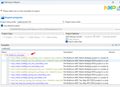

Question1: I'm wondering how to create the project.

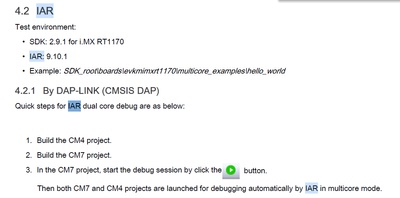

Answer1:  For MCUXPresso IDE, you can import SDK demo as the following Fig show.
For IAR.
Question2:  Should I configure, generate all peripherals in the master core (CM7) or on separate cores? And what should I do if both cores are using the same peripherals?
Answer2:  Please note that multi-core can not using the same peripherals at same time.
Please refer to the AN13264 and AN13114
Wish it helps you.

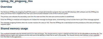

I need to share 1024 bytes data from CM4 to CM7. Should I use MU, SEMA4 or Free-RTOS Message Buffers for this application for best performance?
If using Free-RTOS how can I config receive data via IRS RTOS?

Hi @nampt ,
I think you can  refer to the SDK demo shown in below Fig.
Best Regards
