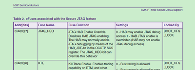

I have below queries still so can you please answer those as my purpose is to ENABLE and DISABLE JTAG as per need(Not permanently enable or disable).
  1. SJC_DISABLE Fuse : 0 - JTAG is enabled, 1 - JTAG is disabled
    • Can we DISABLE JTAG by burning this eFuse using NXP MCU Boot Utility and again ENABLE?
  2. What is the purpose of JTAG_HEO eFuse? Can it re-enable JTAG after disabled previously?
  3. I am using NXP MIMXRT1064xxxxA processor so same document and script is valid for this processor as well?

  You may misunderstand the fuse function, fuse, just can modify from 0 to 1, if you burn it, it can't be back any more to this chip.
  Answer your questions:
  • SJC_DISABLE Fuse : 0 - JTAG is enabled, 1 - JTAG is disabled
=>Answer: After it is 1, no longer modify it back to 0 anymore. It is the fuse bit feature.
  • What is the purpose of JTAG_HEO eFuse? Can it re-enable JTAG after disabled previously?
=>Answer:  If you don't use the secure, don't need to care about it when you just want to use the JTAG enable or not. as it is used for the HAB.
  • I am using NXP MIMXRT1064xxxxA processor so same document and script is valid for this processor as well?
=>Answer: yes, RT1064 is the same, you can use it. But please make sure you need to use the secure JTAG or not, if just the JTAG/SWD switch or disable, you don't need to totally follow the AN with secure.
