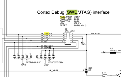

Currently we've been using JLink for debugging our custom RT1176 based boards. Now we evaluate a switch to MCU-Link Base, but I'm facing problems during the connection.
The LinkServer application reports unconnected pins. But we verified the correct connection of the MCU Link Base pins on J2 (SWD interface):
  • MCU-Link J2 pin 1 3V3 connected as VREF
  • MCU-Link J2 pin 3,5,7,9 GND connected
  • MCU-Link J2 pin 10 RST connected
  • MCU-Link J2 pin 4 SWD-CLK connected
  • MCU-Link J2 pin 2 SWD-IO connected
We're only not using MCU-Link J2 pin 6 SWO, which is left floating.

Hi raddeh,
Looks like you werent able to resolve this problem? If that's the case and you still want to troubleshoot, could you:
  • Confirm what supply voltage you are using
  • Let us know what pull ups/downs you have on the SWD connections (if any)
  • Let us know what is connected to pins 7, 8, 9 and 10 on your board

Littell
Could it be a cable problem from the MCU-Link to your board?

Pavel_Hernandez
Hello, my name is Pavel, and I will be supporting your case, I reviewed the schematic and maybe have a confusion about the SWD interface. The Interface to debug reported on the schematic is the J6. the J2 must be the SWD to communicate to the LPC55s69 not for debug.
Could you confirm using the J6?

raddeh
Yes, I'm using the J6 port (2x5 pin connector). I mistyped in the original post
