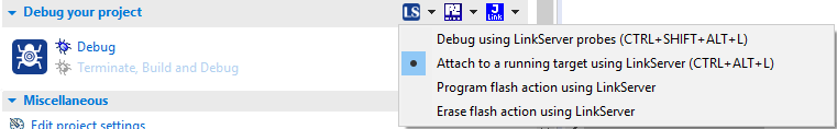

jorge_a_vazquez
Hi Merav Strassberg
Can you please confirm that you don't have selected the "Attach to a running target using LinkServer" as the image below?
If you select this option, it is marked as default, so you have to select the debug option for the new .lauch configuration.
Hope this helps
