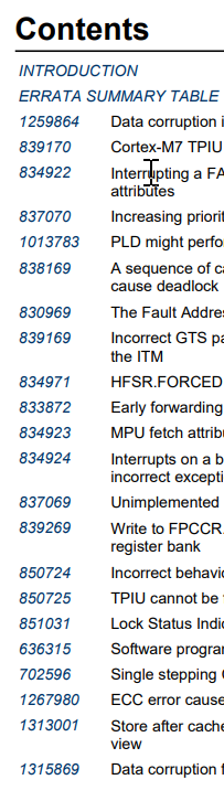

Hui_Ma
First of all, sorry for the later reply.
I checked the ARM Cortex M7 errata file and couldn't find errata ID 838869.
Thank  you for the attention.

Hui_Ma
Hi Simon,
Yes, I saw the void GPT2_IRQHandler(void) function with Cortex-M7.
While, could you guide me where the void GPT2_IRQHandler(void) function located (which c code)?
Thanks.

Hui_Ma
Hi Simon,
Thanks.
While, I don't find <interrupt.c> file form current i.MXRT1060 product MCUXPresso SDK software package.
Could you guide which software package you are using?
best regards,
Mike
