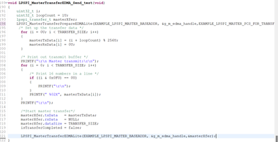

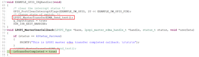

I did  a test for you, I can start the DMA transfer within the interrupt ISR and generating a DMA channel major loop interrupt after the transfer.
I merge SDK demo "evkmimxrt1024_igpio_input_interrupt" and "evkmimxrt1024_lpspi_edma_b2b_transfer_master". I use MIMXRT1024-EVK board.
When I press SW4 button, in this GPIO IRQ Handler, call LPSPI_MasterTransferEDMALite function , then I can see that the program can enter LPSPI_MasterUserCallback callback function.
Wish it helps you.
