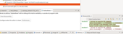

We have developed a custom PCB based on the IMXRT1176 MCU, utilizing the same QSPI Flash as the IMXRT1170-EVK evaluation board. I am currently working on running a simple "blinky" application on the board.
Using the sample from the SDK, I modified the LED to GPIO13, IO7. The application works as expected when executed from internal RAM (by linking the application to RAM) within the MCUXpresso IDE, and I am able to debug without any issues. However, when attempting to run the application from external flash, I encounter difficulties. Specifically, I am unable to debug using the J-Link interface. I have also set the boot mode to [10] for internal boot, but the problem persists.
I have attached some screenshots for your reference and would appreciate any guidance you could provide on resolving this issue.
 While debugging I get this deadbee error and no LED glows.

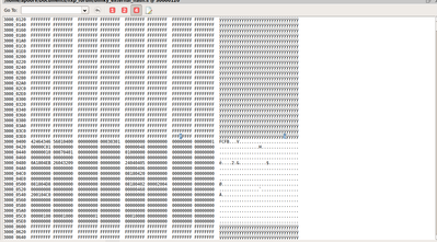

This is the Jflash window showing that the boot header was added properly by the MCUXpresso .  
