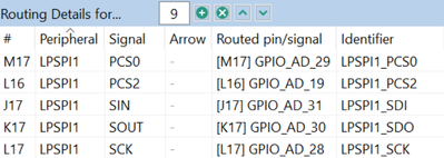

I am using the RT1160 on a custom board. On the board, I have got the LPSPI2, LPSPI4, and LPSPI5 modules working without any issues during debugging. All these modules use conventional SPI communication, so not half-duplex.
I am using the MCU-Link debug probe with the MCUXpresso IDE.
The pin configuration of the LPSPI1 module is shown in the image below.
Thanks again for taking a look.
