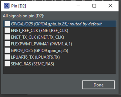

In MCUXpresso IDE pin config tool shows the following for GPIO_EMC_25:

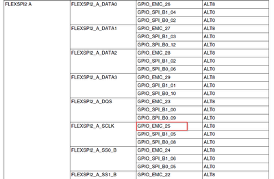

However, in datasheet it says that it can also be FLEXSPI clock:
Is there a reason I do not see this option for mux? I can find all the other signals specified in picture 1 in the reference manual, but not FLEXSPI.

Thanks for the answer. How do I avoid these mistakes in the future? The pin is mentioned in the MUX table after all as FLEXSPI clock using ALT8. When I check the GPIO_EMC_25 pin, I see:
Select one of iomux modes to be used for pad: GPIO_EMC_25.
000 ALT0 — Select mux mode: ALT0 mux port: SEMC_RAS of instance: semc
001 ALT1 — Select mux mode: ALT1 mux port: FLEXPWM1_PWMA01 of instance: flexpwm1
010 ALT2 — Select mux mode: ALT2 mux port: LPUART6_TX of instance: lpuart6
011 ALT3 — Select mux mode: ALT3 mux port: ENET_TX_CLK of instance: enet
100 ALT4 — Select mux mode: ALT4 mux port: ENET_REF_CLK of instance: enet
101 ALT5 — Select mux mode: ALT5 mux port: GPIO4_IO25 of instance: gpio4
Here the pin is never mentioned as FLEXSPI clock pin. What is the correct way to read the manual regarding the pinout then?

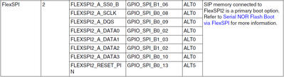

-- In Table 9-1. ROM Bootloader Peripheral PinMux, it demonstrates the Flex_SPI pins that connect to internal QSPI and other pins can't work as the Flex_SPI pins except for these GPIO_SPI pins.

I see. However, in chapter 10.1 Muxing Options (continued) it has the following:
What is meant by ALT 8?
How can I identify that this is not a real option?

-- The RT1064 is derived from the RT1060 series, so its RM may keep some content from the RT1060's RM, however, it's not suitable for the RT1064 and I'll report it to the Document team for checking.

-- Please refer to Table 9-1. ROM Bootloader Peripheral PinMux, just as I mentioned in the previous reply.
