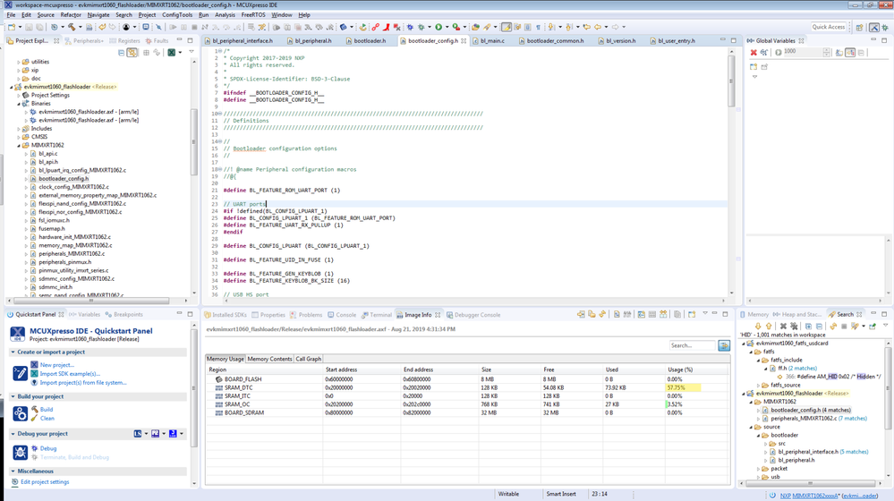

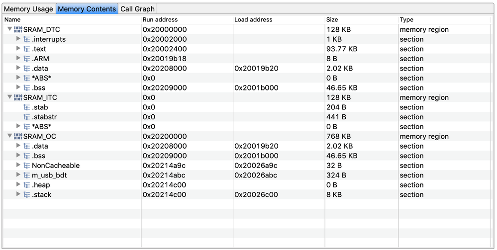

Then we tried both Debug and Release Build, but the result didn't seem to fit into the memory's size.
We've attached Binary's Image Info.
What are the steps required for the correct compilation of the flashloader example?

Hi Daniele:
Please disable some features that you don't need it. Then you can get a small size. for example, if you don't need USB  HID, disable it.
please edit it in bootloader_config.h.

DanielePagani
    Hi danielchen@fsl,
your suggestion has solved the size problem.

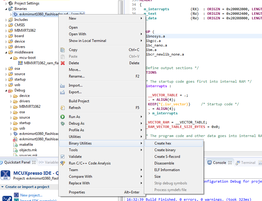

You can generate the binary file with MCUXpresso IDE. Please use the binary utilities.
