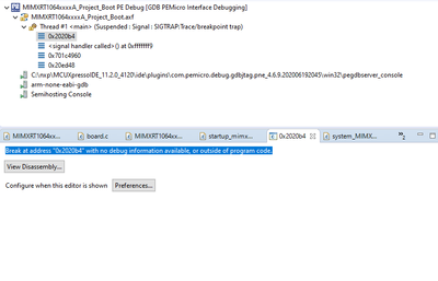

I'm very new to NXP and ARM microcontrollers and I'm having a very hard time to figure what I need to do to get the iMXRT 1064 booting with barebones code.
I have bought the MIMXRT1064-EVK and have managed to run the example codes. But the codebase for this has so many components that I do not need.
I still can't find a guide document that lays out exactly what needs to be done to just get the iMXRT1064 booting (internal flash), without any of the EVK components.
I'm trying to make a new project using the SDK but set as "no board". I'm not sure what I need to change from the default project to get it running. The project is building but at runtime I get this error:
"Break at address "0x2020b4" with no debug information available, or outside of program code."

In order to boot from the internal QSPI flash you need to ensure that you have a valid boot configuration at the start of its memory (0x70000000) followed by an image vector table (0x70001000) plus boot data (0x70001020) and optionally DCD data (0x70001030).
The image vector table is what points the processor to the final start up reset vector so that the code can begin its execution. From this point on standard general ARM details then apply.
See some introductory/concept videos at https://www.youtube.com/watch?v=GXztWg9m6_8&list=PLWKlVb_MqDQEOCnsNOJO8gd3jDCwiyKKe
https://www.utasker.com/iMX/RT1064.html
To understand the full details you will need to study the documents in some detail and reference working examples since there are a lot of configuration possibilities and not all information is obvious or simple to find. Errors will result in no operation (what you are seeing is such an error which causes the internal ROM loader to be taken and thus the address that you are seeing) and starting with a working reference and gradually making your own version will be possible, but using small steps so that the reason for failure can be identified at each step.
