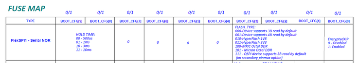

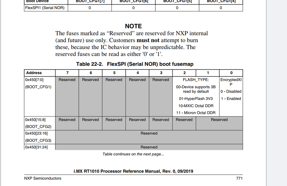

The value of BOOT_CFG1[7:0] is 0x0000FFFF. However, there is a 1 in bits [2:1], which selects the flash type as Micron octal DDR. We are using Micron NOR flash through FLEXSPI, which is in quad mode. Is this the reason our booting is not happening from QSPI NOR flash? If so, the register is in read-only mode. How can we change the value?
Additionally, the FLEXSPI NOR image layout specifies that the field 0x0000~0x00FF should be an OTFAD keyblob (if present). Is it necessary to generate this keyblob? If yes, how should it be generated?flash confg.png

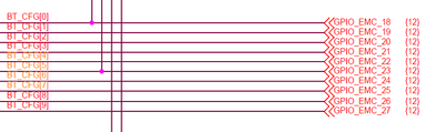

Thank for the provided information, with respect at your issue, you should check your connections of the BOOT_CFG pins, as well as making sure that nothing external to the MCU might be changing interfering with the signals of these pins during the booting process. It's important that their values are logic 0 when the processor is in BOOT process, to allow the processor to communicate to a Serial NOR, as shown in the image below:
In the next image you can see which GPIO are the BOOT_CFG pins:
Also, if you experience any issue, do not hesitate to let me know.

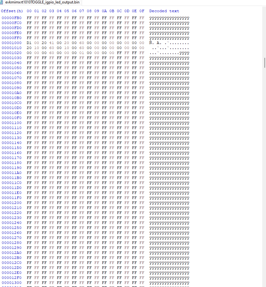

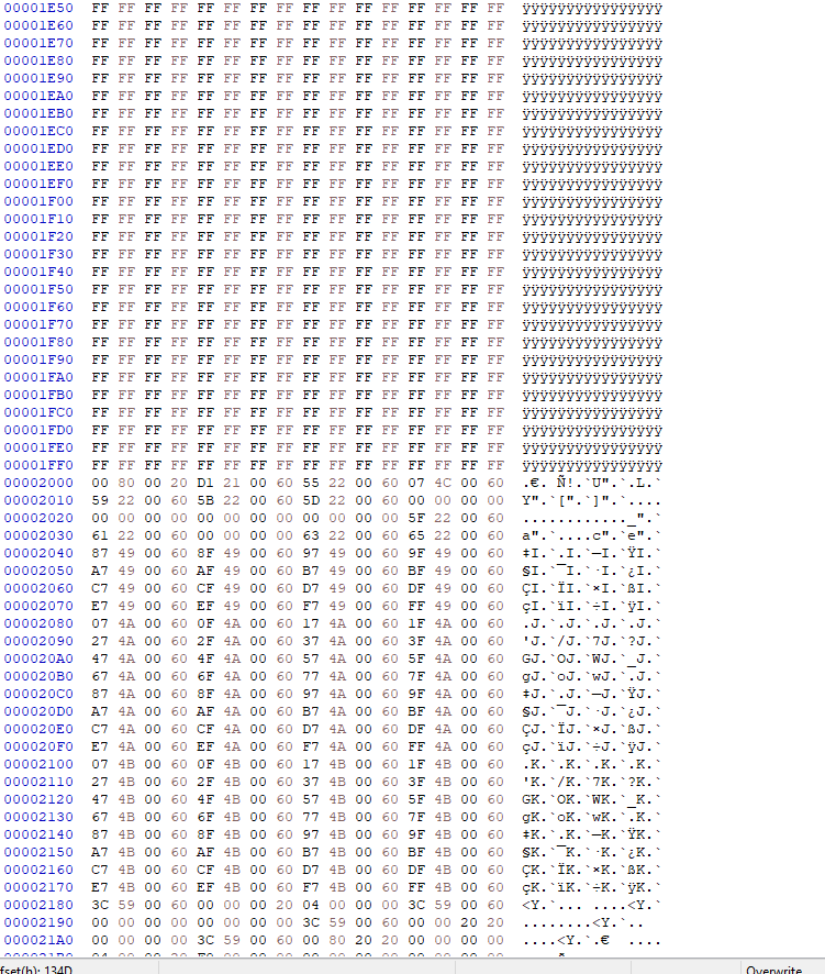

In the binary file that is generated for my application code I found that the IVT structure and boot data is between 0x1000 - 0x102F and my application binary starts from 0x2000.There are all F's in between 0x1030 to 0x1FFF.Is it correct?

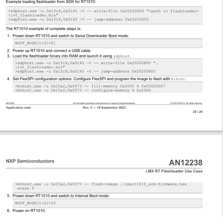

Before loading program image do I need to flash any flash loader algorithm?
It is mentioned in the PDF AN12238.
