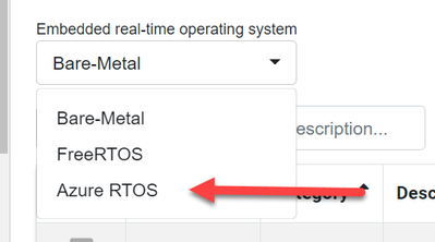

Sabina_Bruce
Hello Seif,
Hope you are doing well. When this question was originally posted the azure examples were for iot and did not use azure rtos. This has now began to get implemented in our SDKs. You may choose the RTOS you would like to use when downloading the SDK a pop down option allows you to choose between bare-metal, freertos or azure rtos.
Please note this is not available in all our microcontrollers.

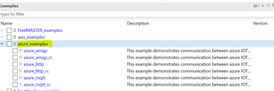

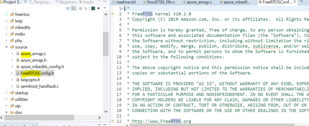

Seif
Hello Sabina @Sabina_Bruce,
Are you talking about the following azure examples in the RT1050 SDK ?
Are you sure these example are RTOS examples ?
The question mainly was about azure RTOS (threadX) and I think these examples are still using FreeRTOS from Amazon:
Can you please clarify that ?

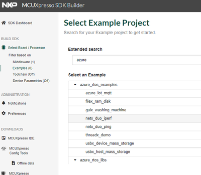

brendonslade
Azure RTOS examples are contains under the RTOS directory in the SDK package. You can also browse what is there using the mcuxpresso.sdk.com package builder; use the Middleware and Example filters to see that:
Azure Cloud examples (as you were looking at) in SDK2.8 are older, and are based on a FreeRTOS implementation. From SDK 2.9.1 (see Jan 21 release) we will have examples for connecting to Azure Cloud based on Azure RTOS (ThreadX) for platforms with Ethernet. This release will also add support for the other i.MX RT10xx devices.
