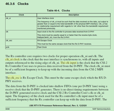

In the CS2 mipi code I found these clocks:
CLOCK_SetRootClock(kCLOCK_Root_Csi2, &csi2ClockConfig);
CLOCK_SetRootClock(kCLOCK_Root_Csi2_Esc, &csi2EscClockConfig);
CLOCK_SetRootClock(kCLOCK_Root_Csi2_Ui, &csi2UiClockConfig);
Can anyone explains what these clocks are for?
Thank you!
26,990件の閲覧回数
kerryzhou
Hi fmabrouk,
   About your mentioned clock, you can find it from the RT1170 reference manual:
Wish it helps you!
Kerry
