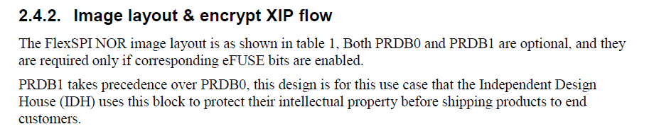

Another screenshot from the AN: 12079
I will let nxf51209 follow up with your questions.
Seif

Yes I do have access to both those documents, even though they are for the RT1050. I am actually working on the RT1021 (RT1020-EVK) not the RT1050. I'm told most of what is in those documents applies, but there are features that the RT1050 supports that are not fixed on the RT1020 silicon.
So yes, the PRDB0/PRDB1 are optional, although you do need at least one to get XIP encryption working afaik.
PRDB1 takes precedence over PRDB0 - what does this mean exactly?
E.g. Does this only matter if there is overlap in the regions being encrypted? So if they do overlap they get decrypted twice?
I understand why you might need two PRDB blocks, one for different software providers. And so one would provision the flash with one PRDB region and the second would used the other PRDB.
I still don't understand how the XIP Encryption example in AN12079 works though. It sets BEE_KEY1_SEL to b11, but does not set up the PRDB1 block. It does set up the PRDB0 block and also sets BEE_KEY0_SEL to b10. Which makes sense if you are only interested in PRDB0, but why set BEE_KEY1_SEL to b11 as well, and not set up the PRDB1 block? If the RT1020 cannot find a valid PRDB1 block it should just generate a HAB error and stop. So what am I missing? One way this could work is if the RT1020 ROM interprets the SW_GP2 setting - which is zero - as 'ignore the PRDB1 block'.

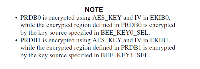

I've had another look at the documentation:
Security Reference Manual for the i.MX RT1050 Processor, Rev. 1, 04/2018
3.6.2.5 Encrypted XIP Flow
If the PRDB is invalid it just ignores it.
However what happens if the KIB is invalid? I guess it will still decrypt it, end up with a garbage key and IV and then decrypt the PRDB which will also become garbage. So bottom line is, if the BEE_KEYn_SEL is set but the PRDB is invalid it is ignored. Can somebody please confirm my understanding.
So if my understanding is correct, (ie. if the PRDB is missing/invalid then it is ignored), that would explain why the example in AN12079.pdf works. So why did they set BEE_KEY1_SEL = b11?
However I have a situation where I have used BEE_KEY0_SEL = BEE_KEY1_SEL = b10 and that refuses to boot with just one PRDB. It does boot if I have two PRDBs, but does not observe the encrypted XIP setting (GPIO not fuse). Perhaps I've done something wrong. I will look again.
In the meantime, please confirm my understanding is correct, and also see if you can find out why they set BEE_KEY1_SEL = b11.
